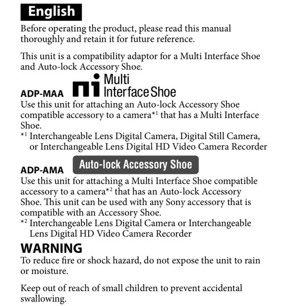

ADP-MAA adapt oldest flashes to newer cameras.
ADP-AMA adapt newer flashes to oldest cameras.
Where:
- newer has MI shoe interface
- older has auto-lock shoe interface (ex Minolta)
Thanks for the reply.
From the picture I don`t think any of my accessories would fit the MAA version so it looks like I require the AMA. version.
You are wrong.
RX10M4 has for sure MI shoe. So, if you have some old sony/minolta flash with autolock shoe you need for ADP-MAA.
Otherwise you don’t have a compatible sony/minolta accessories
