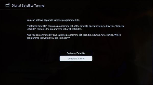

  3. Screen11.jpgNow you have to select whether you would like to use a satellite provider or not. If you use a satellite provider (e.g. Sky) select ‘Preferred Satellite’ and choose your operator. If you select this option the TV receives the channel list from the operator – so the order may be fixed. If you don’t use a satellite provider, select ’General Satellite’. With this option you can sort your channels individually after tuning (an option that is also available with a satellite provider).

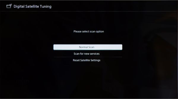

  4. IScreen12.jpgf you don’t run the initial set-up you will see this screen. Select an option  to proceed.

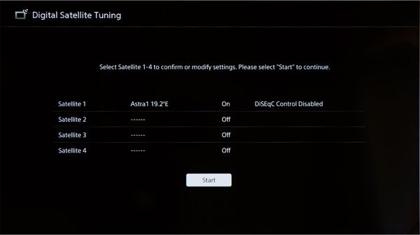

  5. Screen13.jpgIn this step you will see the list of available satellites. How many and which satellites you see depends very much on your antenna configuration. If you have a basic set-up with only one dish and LNB your screen will probably look like this screenshot. You can start the tuning process now. If you’re an advanced user, read on for how to customize your scan.
