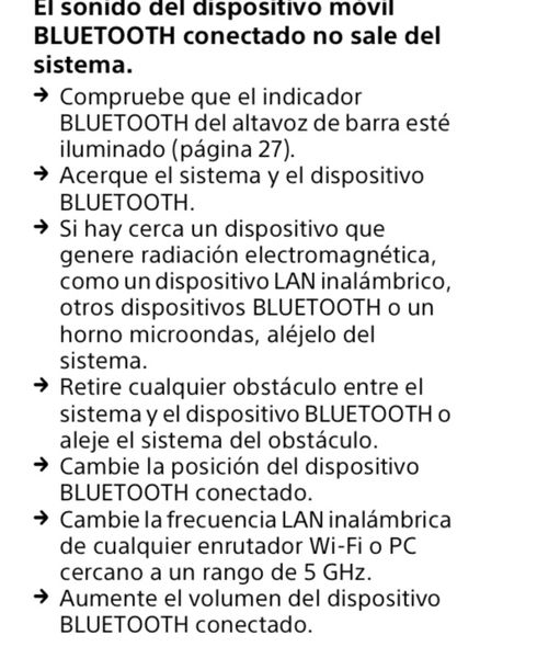

Sigue estas recomendaciones
https://www.sony.es/electronics/support/home-theater-sound-bars-home-theater-systems/ht-g700/downloa...
