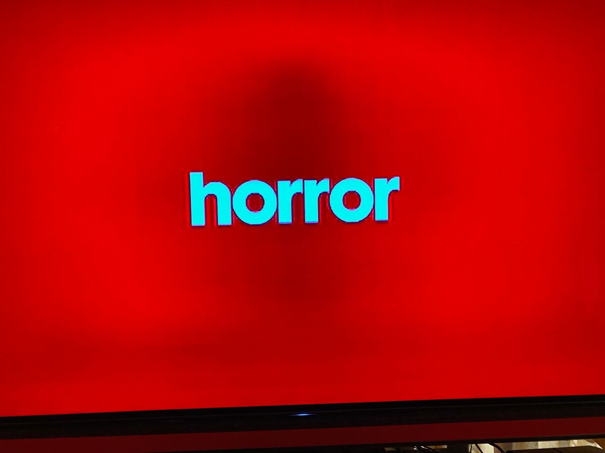

I have had this OLED TV about 3 years and am always careful about screen burn, not leaving it on the same screen for long. I also do the screen refresh procedure when the TV requests it. The TV has been superb.
In recent months I have spotted that some faces showing in a particular part of the screen have a green tinge to them. When there is a completely red screen you can clearly see that a patch maybe 5cm by 8cm does not have all of the red firing. The red on that patch is not so intense. This is in the midway across the screen about one third down so nowhere where on-screen graphics would show and possibly cause a problem over time. It is also a roughly oval patch bearing no relation to anything that appears on the screen images.
A screen refresh didn’t solve it and, although I have a 5 year guarantee, I am not keen to send it off for screen repair or replacement. In everyday use it just means that any faces which appear in that zone have a green shade. It seems to mainly affect skin tones because other images don’t have such a noticeable,shading.
Does anyone know what causes this? We bought the OLED TV after 2 previous Sony LED TVs completely failed electronically (not screen related) and it was their “premium” screen at the time.
Any advice gratefully received as we are getting less and less impressed by Sony’s TVs!

The red screen in the image shows a patch where the OLED screen colour is not even. This is not of a shape or in a position where on-screen graphics could have caused damage. When viewing TV from any source - external, TV tuner or apps - the green colour shade shows. This shows it is a fault in the panel. This is especially noticeable in faces in the faulty zone. When a face moves across the screen it goes from normal skin tones to greenish then back again to normal.
The image shows a panel that was burnt seen often associated with news presenter always in the centre of the screen. Don't know if this is what you normally watch and for how long but since you have a warranty I do not know what you are waiting for. Just as a possible cause you didn't specify it the tv was always plugged to power when not in use.
Thanks. I didn’t know that a newsreader’s face could cause burn in. I thought it was just static things like tickers, logos etc. Your comment is helpful. We don’t watch news channels for prolonged periods and leave the screen off in standby when not watched.
You mention leaving the TV plugged in to a power source - when not watched it is on standby with the screen off. Does this have an effect too?

Yes, every 4 hours of use the TV cleans automatically the OLED screen to prevent retention and burn in. Let us know what they say since I have the very same tv bought on October 2017
. Never heard till now any burn in effect apart few faulty panels that developed a regular square in the middle after the first panel refresh (and that could be fixed without even changing the panel)

Two Sony agents in the past two days have stated that there is a known issue with their OLED panels and this defect Developing over time. Two independent, experienced TV engineers have also said they have seen it too.
So the only thing stopping me accepting this replacement is how old a “factory refurbished” TV might be. If,as Sony agents have now said, thus problem appears over time we would rather have a new replacement or one which hasn’t gone too far down the time to faults appearing. I certainly don’t want to be dealing with Sony Support in 18 months or so - or in fact ever again if I can help it.
