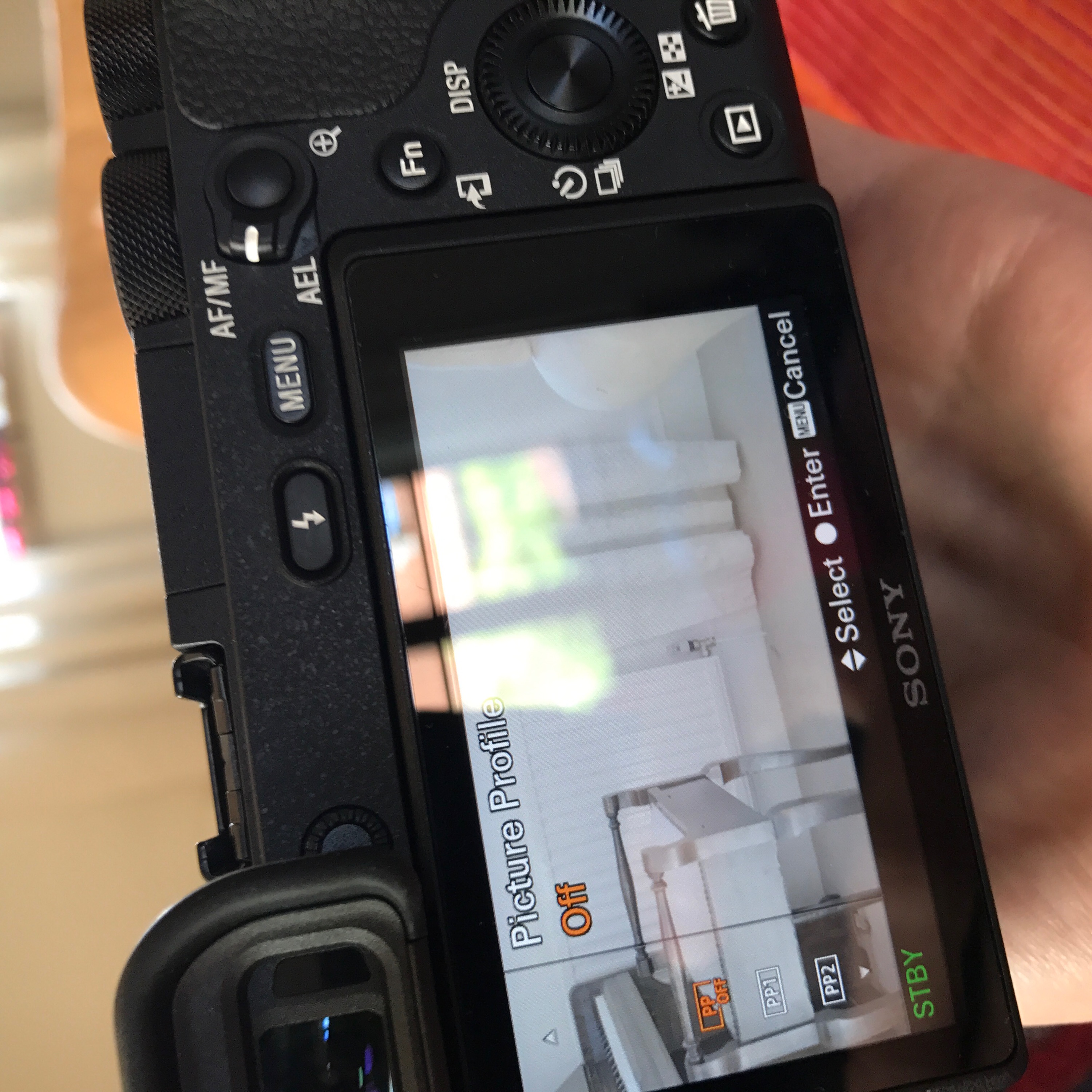

Left my a6500 turned off in MOVIE mode with Picture Profile pp7 selected, but now I cant turn it off from pp7. no matter what I do, it stays the same. The only way i can change it is in AUTO still mode and useing picture effect, which i want to use neither.
I've tried updating and resetting the camera... does anyone know a way around this?

My screen doesn't come up with a "reset" option
Thanks for checking and for the photos too

Support got back, told me to do all the stuff that I've already tried, but they mentioned the Picture Profile reset again and I realised how to do what you said before. So I now have all the Picture Profiles how they should be, but "Picture Profile Off" is still in slog3 which is still frustrating, and there doesnt seem to be a way around it!
The video below demonstrates the problem and how the Picture Profile will only turn off in complete auto still mode.
